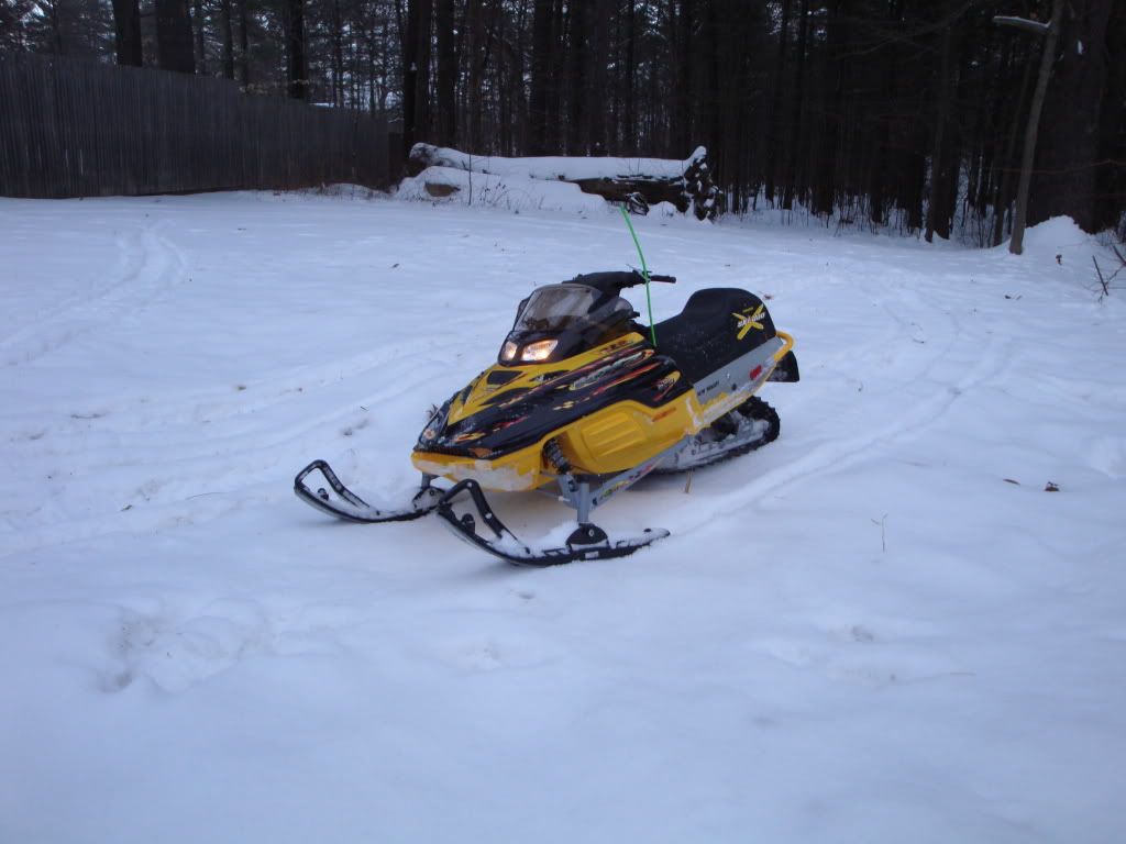

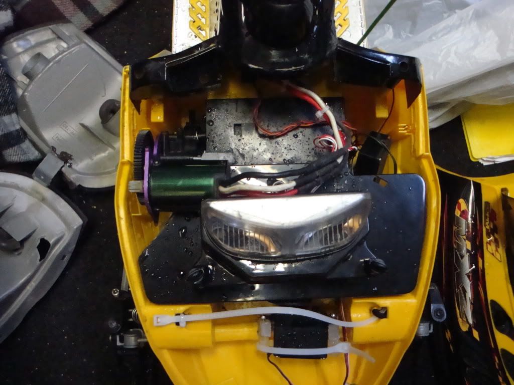

Hey guys, heres my brushless sled, Castle Sidewinder 5700. Wheely King tranny, Nitro rustler spur, stock plastic gear, (need to get mod pinions.)
2s lipo. Tq radio. :D

Its one of those new bright ones from walmart, i have 2 of them, the other track im modding with wiper blades to make taller lugs on the track, i have too much power, not enouph traction. We have 3+ ft of snow, if i punch it, it just burys itself.

The 5700 isn't too much? Did you do anything to the rear suspension or idler wheels? Did you do the drive cog mod?

Cut the centers of the cogs and pushed together, oil shocks all round, trx servo, the 57 isn't too much, its pretty good.

I've seen that one, its really nice, this is just stuff i had laying around.
