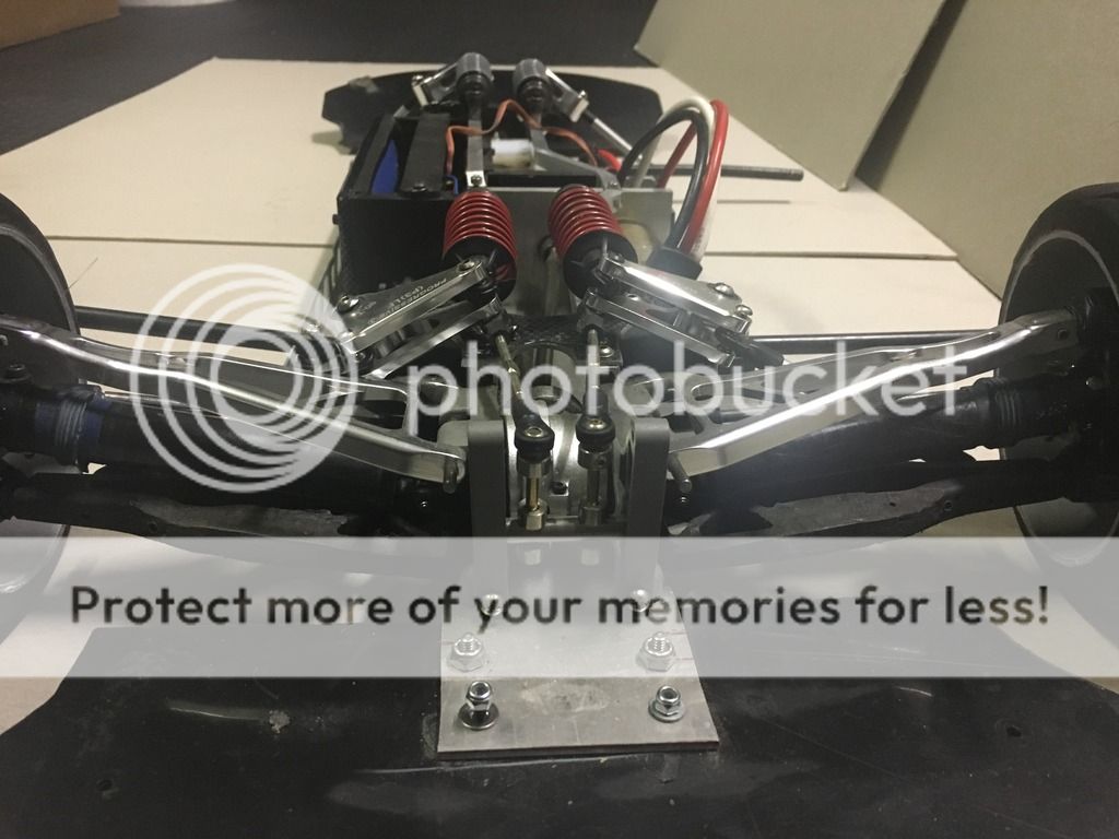

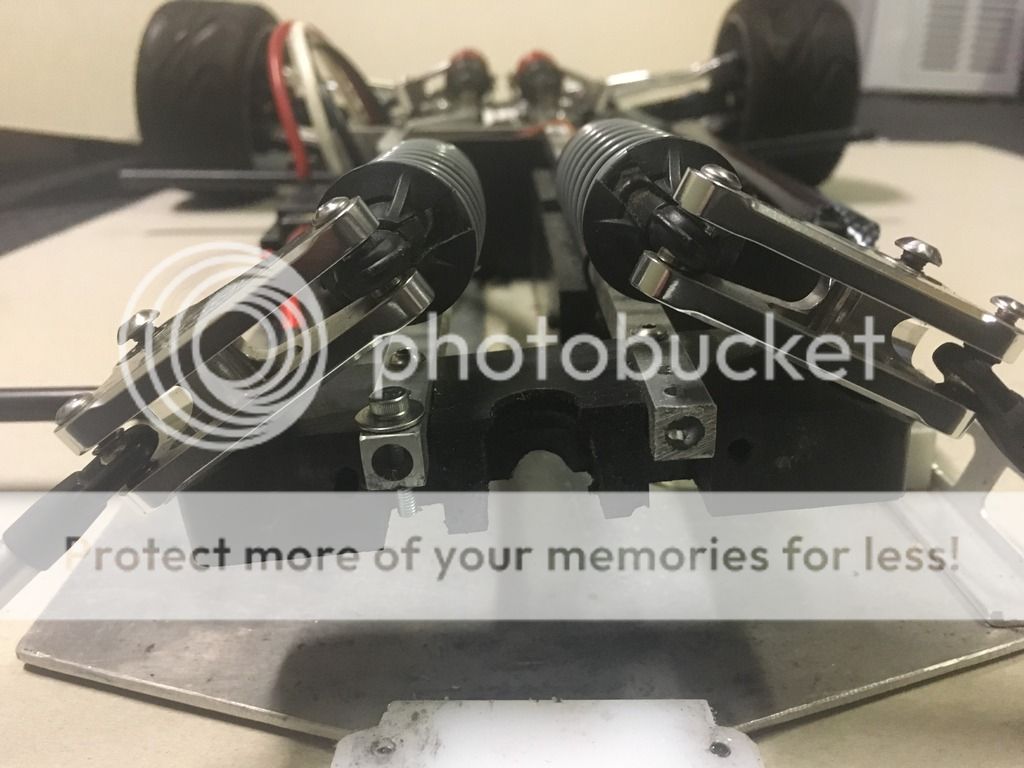

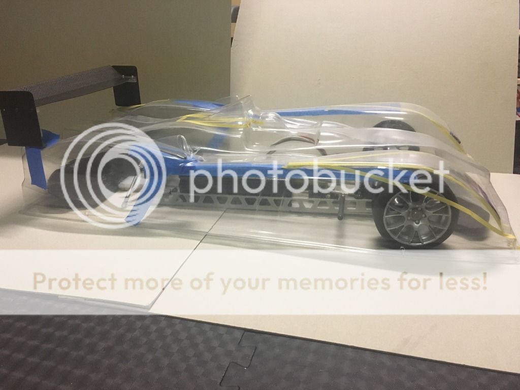

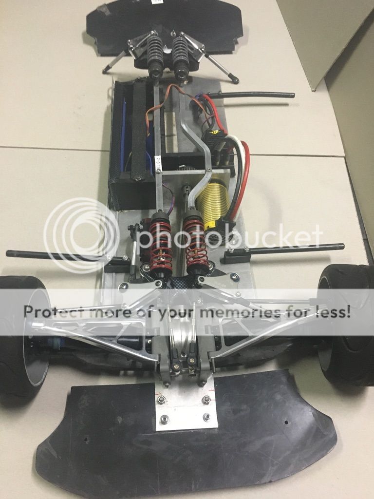

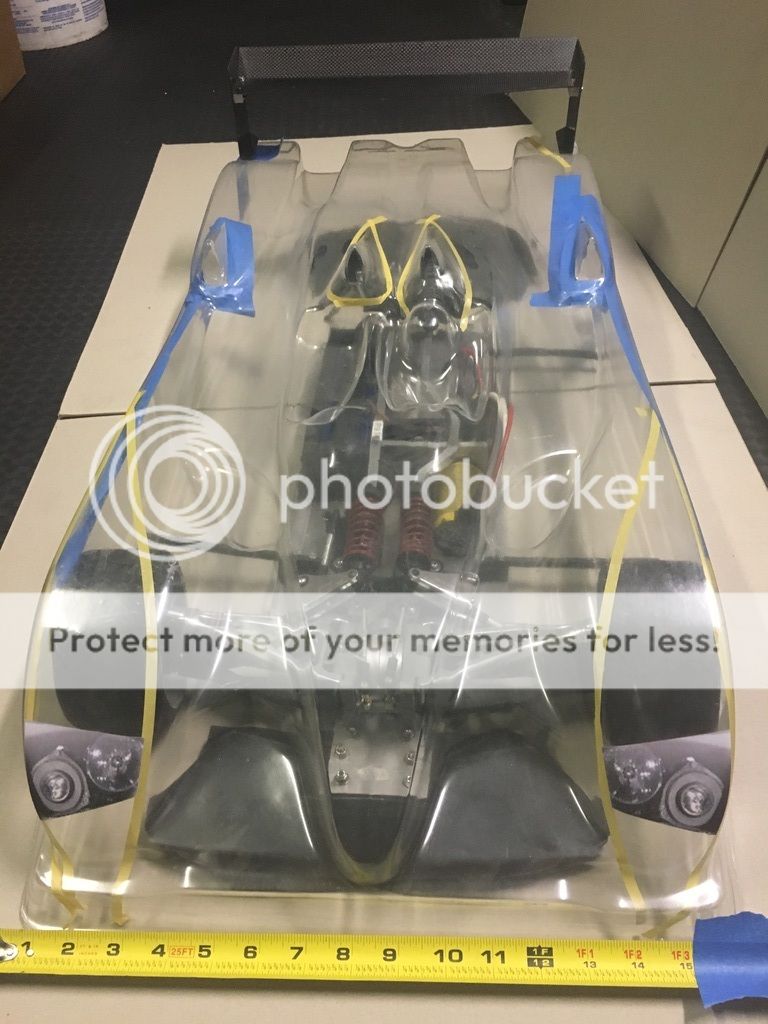

1. New 1/5 Audi R10 Le Mans Race Body
2. New Upper chassis rails
3. New 6s 4000 Lipo battery
4. Re worked Losi Shocks and springs
5. Relocated Shock position.
6. Chassis i snow Equally Balanced Front to rear and Left to Right.
7. Now running Custom Spektrum DX6i DSM Transmitter.
In Progress:
1. Narrowing Wheel Track by 1inch to Fit 15inch wide Le Mans body.
2.Working on Machining new Suspension support from block 6061 t6 Aluminum as after the collision the Delrin Suspension block cracked.
3. Hopes of installing Sliperential.
[IMG][/IMG]
[IMG][/IMG]
[IMG][/IMG]
[IMG][/IMG]
[IMG][/IMG]
Rebuilt, and added Functions Spektrum DX6i Transmitter
Drives Dual ESC Rock Crawler, 1/10 Scaler crawler with Winch, 1/8 Custom Rock Buggy with Dig and Dual steering, Shortcourse truck and 1/5 on Road with a Brake button.
[IMG][/IMG]
[IMG][/IMG]
