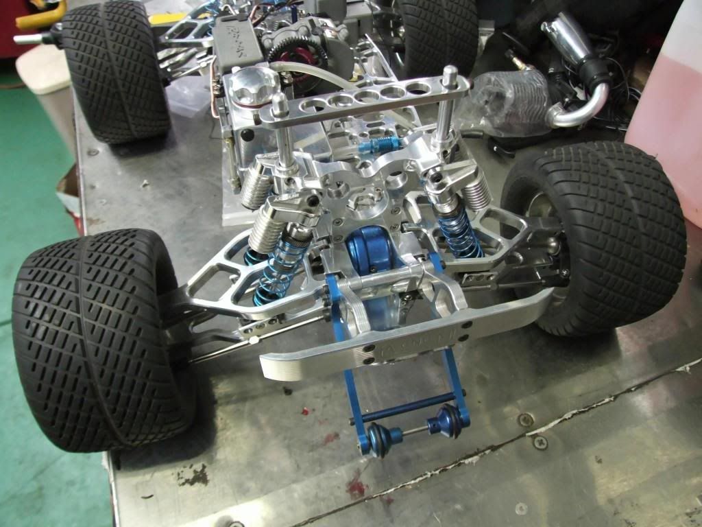

This is the t-maxx I am in the middle of building, I have fitted up a pair of LST2 diffs, I machined the side spacers and diff collars myself, the front one has the extra clearance under it to clear the proline steering links. I decided to spend a little time on the lathe at work as it seems collars are the weak spot when opened out for the lst2 diff (hopefully these will hold up ok)\

the problem with dremmeling standard collars is very little material left behind so they are weak and break if you push the horse power, at this stage I wont making any more but who knows ( its not a quick job on a 40 year old lathe ).
The tires are team orion street sweepers, they came on 1/2 inch offset rims via Ebay.

I shaved down a set of aluminum collars after the 1st set of stockers broke... So far on 6s they've held up... Wonder if these gears would work in a UE ultralite case... Hmmmm...

I'm not brushless, running a .32 Axial big block as picture a few posts back, the diff's have worked a treat, done some pretty hard bashing and even as a heavy weight truck that spends its fare share of time on the back wheels only, I have not managed to break one yet.
I highly recommend this mod for any maxx truck running big horses.
