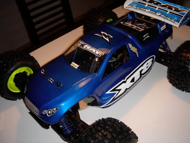

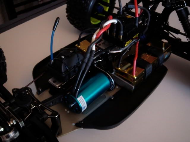

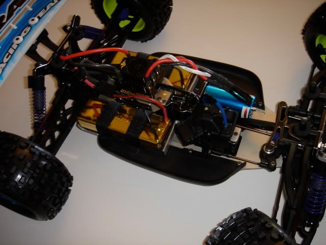

Just wanted to show (off) my first brushless conversion. I dont know if anyone else has done this, but I have added my own touch by turning the centre diff 180 and front mounting the motor (Medusa 36-70-2000). Wasn't too keen on having upto 6s lipo leaning on one side, aswell as having a high centre of gravity. I already have a collection of 2s and 3s lipo's from my rustlers, that will save me some cash. Anyway I still havent run it yet, but it is set up with 4s at the moment for about 40mph.
So what do you think about the front mounted motor? The front to rear balance is very close to the centre.

Looks great! That's what I was thinking would be the best racing setup, and most like the top 1/10 4WD buggies with saddle packs. If there were only some good li-pos in the same relative dimensions as 1/10 saddle packs, this would be a great way to go.

Nice looking rig. It's interesting that you chose this type of layout. This past weekend, I ran both my XX-4 (saddle pack layout) and my Lazer ZX-5 (single pack to one side). The XX-4 seemed to be more balanced, have better turn-in and almost swivel around a turn where the ZX-5 had more push under throttle and in the corners.
I thought to take this into consideration for my 1/8 rides as well. It looks to yeild promising results.

Very nice conversion.

That's a very nice conversion OZ, up there with the best for sure

I love your layout! It looks very "RTR". Nice and clean...

Thanks What's_nitro, thats what I was aiming for. I just need to tidy up the battery wiring after I work out what works best.

That is my prefered setup for BL conversions too. Very balanced in every way. With bulkier A123 batterys one of the simplest solution to get enough room and a good balance. Of course somewhat heavier than with one lipo pack as you need 2 battery holder and 2 batterys with the same capacity as one will always be heavier.

I think for the sacrifice of a little extra weight, there still is an advantage over unbalanced weight.
