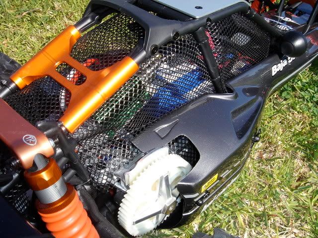

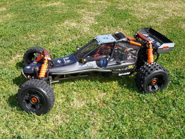

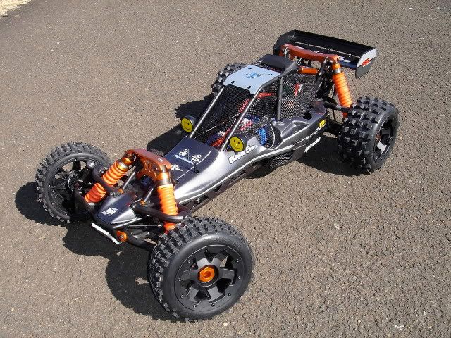

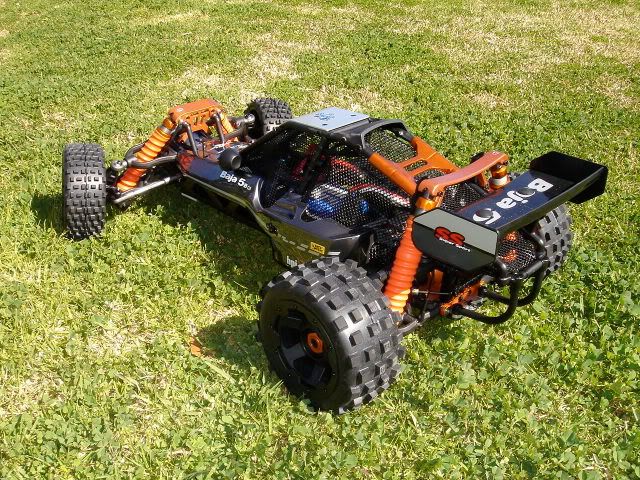

Well after 7 months of building I finally finished my E Baja.
Specs are:
Baja SS
RC-Monster E conversion (thank you Mike for such a great kit)
Neu 2220 550kv
Hyperion 35c 5000mah lipo's 11S (1x5S and 1x6S)
Castle Phoenix Ice HV160
Geared for 50mph.
Here is a short vid from the maiden run.
http://www.youtube.com/watch?v=u-IYRV5JnDg
After 15min Motor was only 130 and esc 115. Lipo's got to 103.
Biggest problem is traction, even with all the weight.

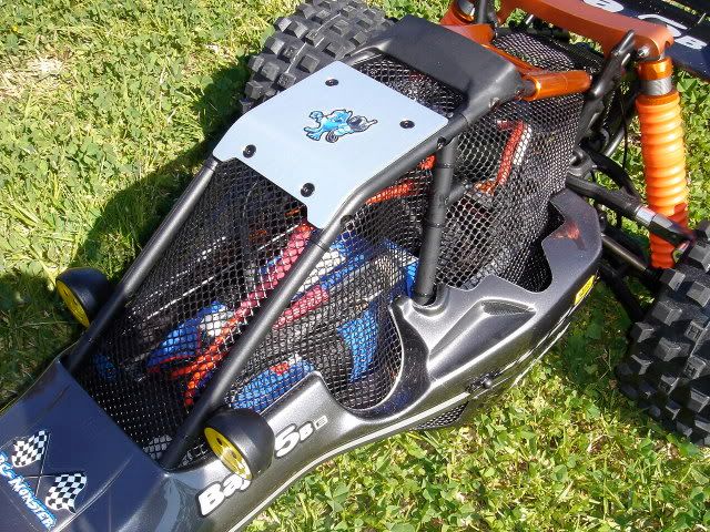

You can be proud of what you have accomplished there. Nice looking toy. For the few upgrades you have in there it looks pretty nice. The video works just fine and shows that you deffinitely have a traction issue there. Proves the point that 4 X 4 is the way to go for the Baja 5b. I would have to believe that if you do some kind of 4WD conversion that you would have an R/C vehicle that could compete on all levels. Very nice rig. I like that netting you installed to protect the internals. have fun.

That is one Sweet BAJA - Good that you got some hi-res pics before the maiden voyage... Congrats....

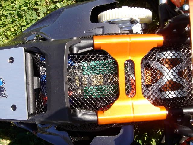

Sweet baja for sure. Love the screen around the roll cage as well nice touch. Any naked pics of how you mounted everything
pinkpanda3310
pinkpanda3310's Avatar
Posts: 1,152
08.22.2010, 09:45 AM
Yeh, that's a very nice looking baja. I think the cage/mesh has something to do with it. I would also like to see underneath. Great job

Really good looking Baja there! She runs great and those temps are well in check.
Have you check the data logging feature of the ICE HV yet? I'm curious as to what kind of output you are seeing.

Thanks for all your kind words guys.
Yeah, the stock settings of the suspension need to be adjusted (aswell as throttle control) to help with some of the traction issue. But apart from that I am very impressed with the outcome of this buggy.
I will try to get some naked shots soon, aswell as some data logged from the ESC.

Here are a few naked shots and some data logging.
[IMG][/IMG]
[IMG][/IMG]
[IMG][/IMG]
[IMG][/IMG]
[IMG][/IMG]
[IMG][/IMG]
So to me it looks like there is nearly 6HP there and max amps at 106.5, impressive. If some of you can help me with working out how my lipo's went, it would be much appreciated. I had the LVC at 3.4v and when it hit, I just disconnected the lipo's and took a reading of voltages and all cells were around the 3.7v mark.
Thanks in advance.
